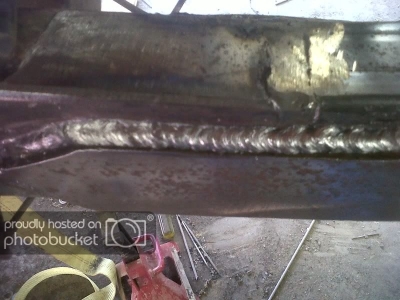

Rear sheet metal has also been dove tailed to the width of the frame rails.

The rear dove tail

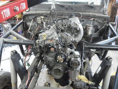

The motor getting fitted in..

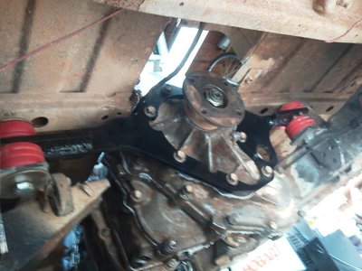

Motor is in and this is where it will sit. These Japanese folks engineered this motor to sit crooked like this.. It looks a little odd at first.

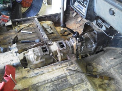

Here is the looonnggg *** drive train.. somehow I've shoehorned it in there and just about have a flat belly.. there is only about 1" of the front drive shaft output hanging below the frame rails.. but a skid plate is going to protect that.

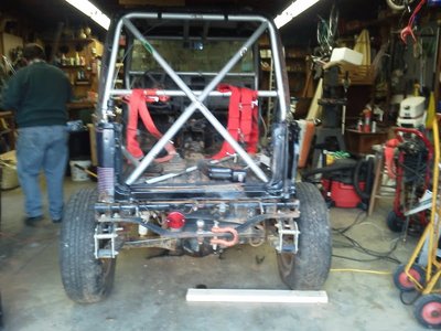

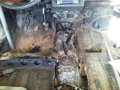

sourced a w56 trans, and a w59 taco bell housing that is needed to bolt it to the motor.

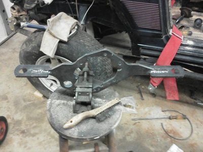

sourced a crawl box, doubler plate, and a 4.7 geared case with a broke input for cheap.. Thought hell one call to trail gear and i can have that fixed since it has a lifetime no questions asked warranty... NOPE, they asked a question... (another story for another time).... But thanks to Harv ill have it back together soon.

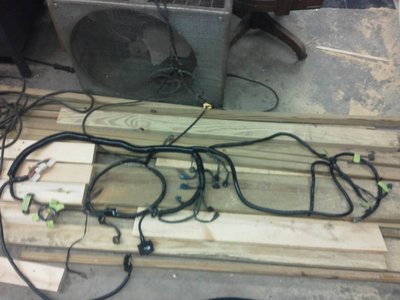

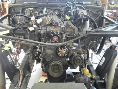

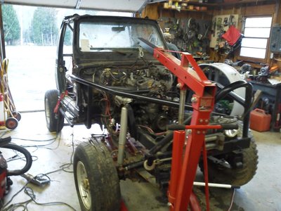

Having a custom stand alone harness built for the motor by a guy on pirate who owed me a favor, so it should be back soon. It will run the motor, and i will have standard gauges in the dash. Prob. source them from summit.

The rear dove tail
